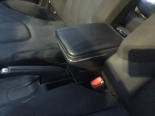

Here is a quick shot. I hope it helps.

Looks nice. Is it firmly attached? Does it feel cheap chinese s*it or is it ok

It's firmly attached. It takes up the 2 holes in the back of the center console. Each one has little rubber bumps that makes it very snug. The leather lid can slide forward and has an internal magnet that keeps it closed. It can't be beat for $50.00.

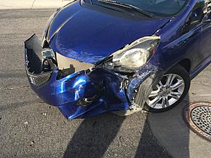

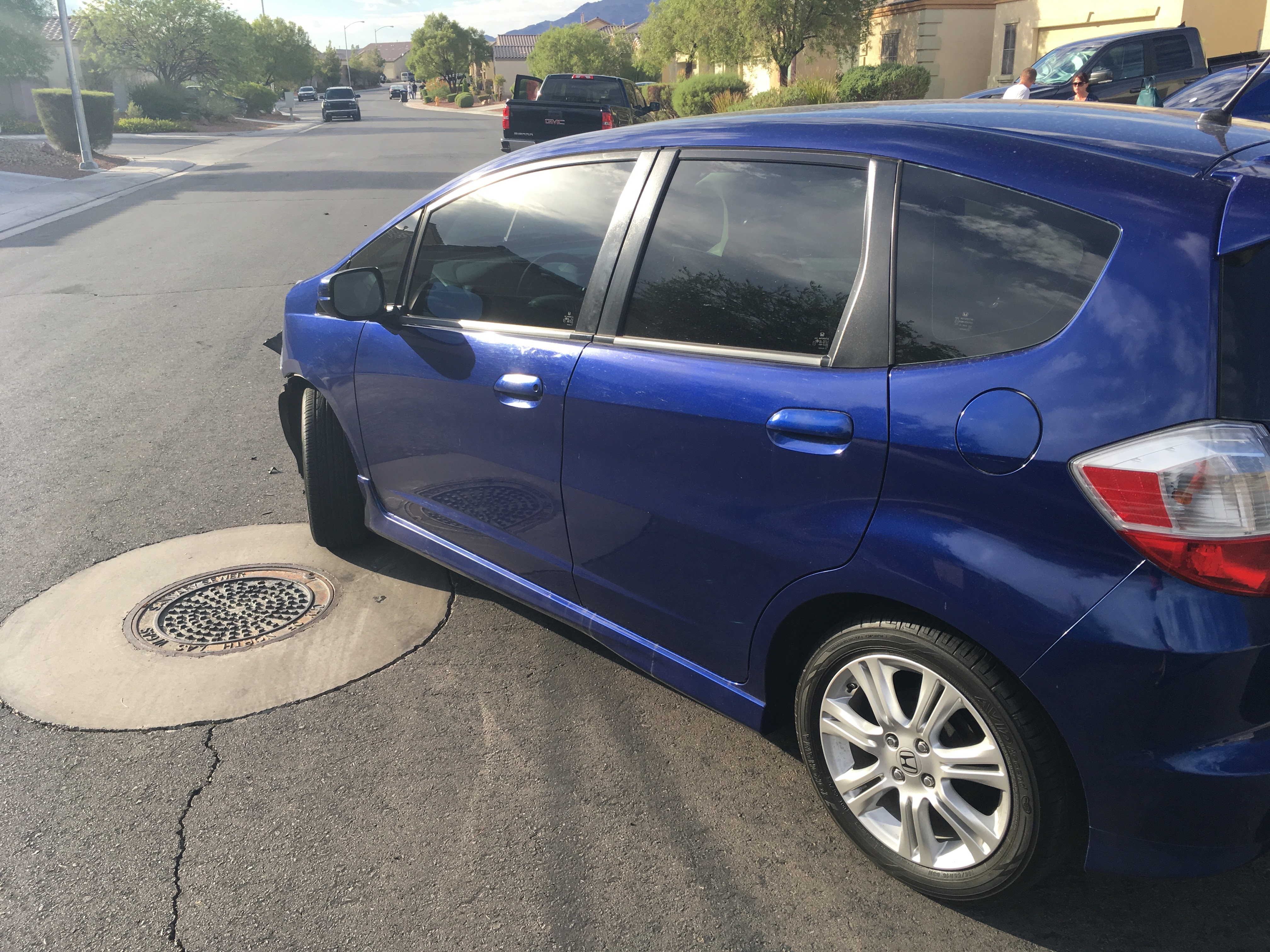

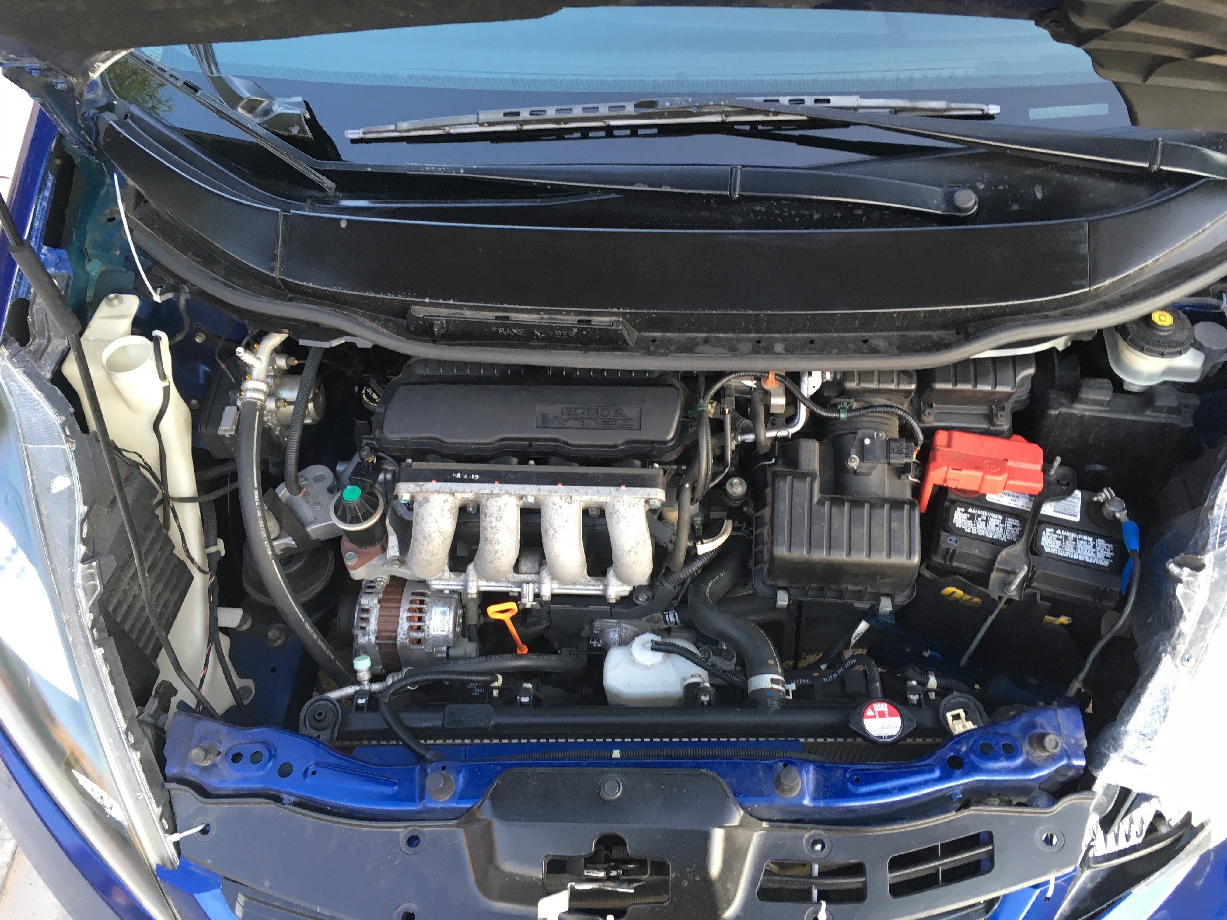

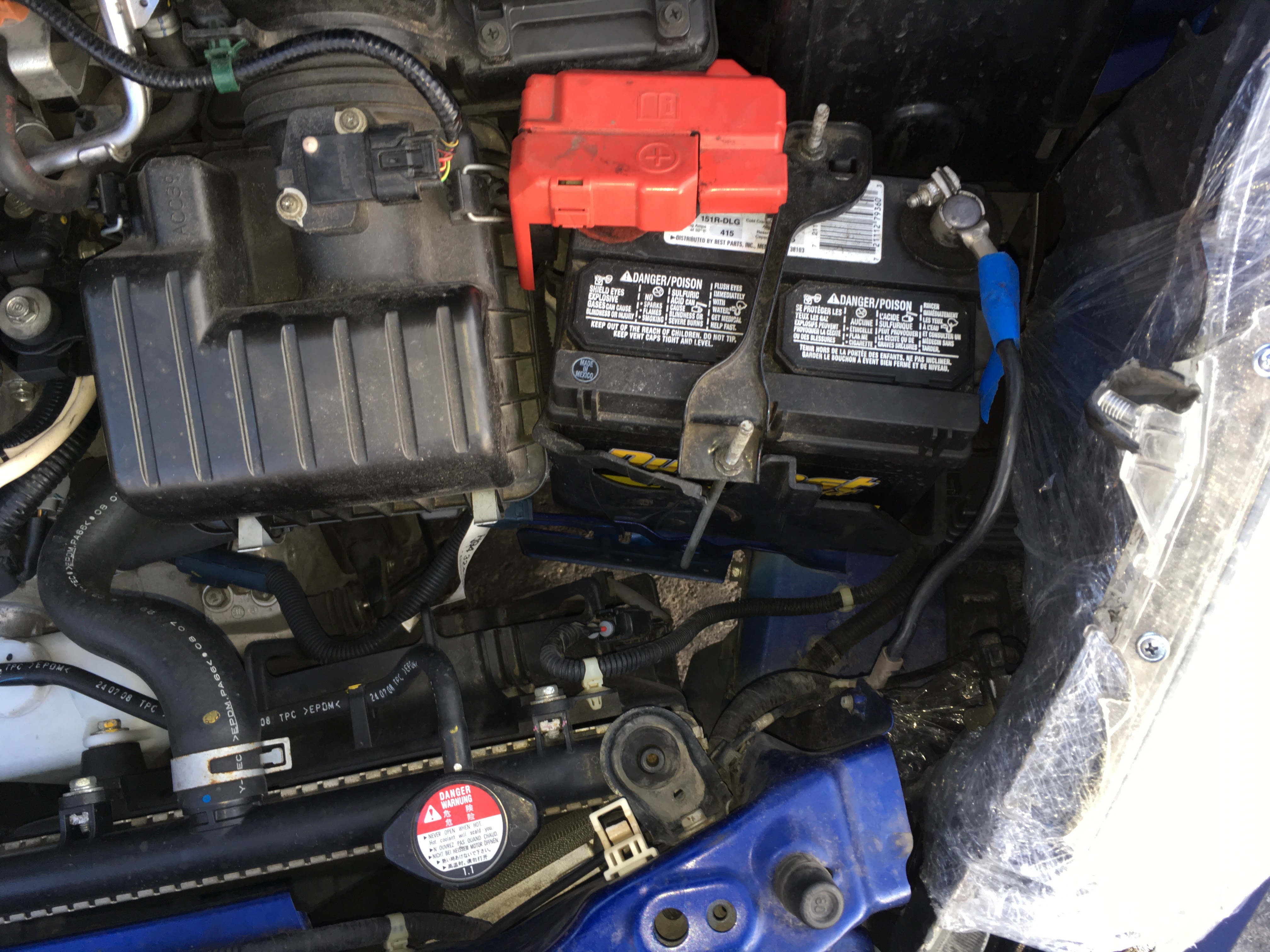

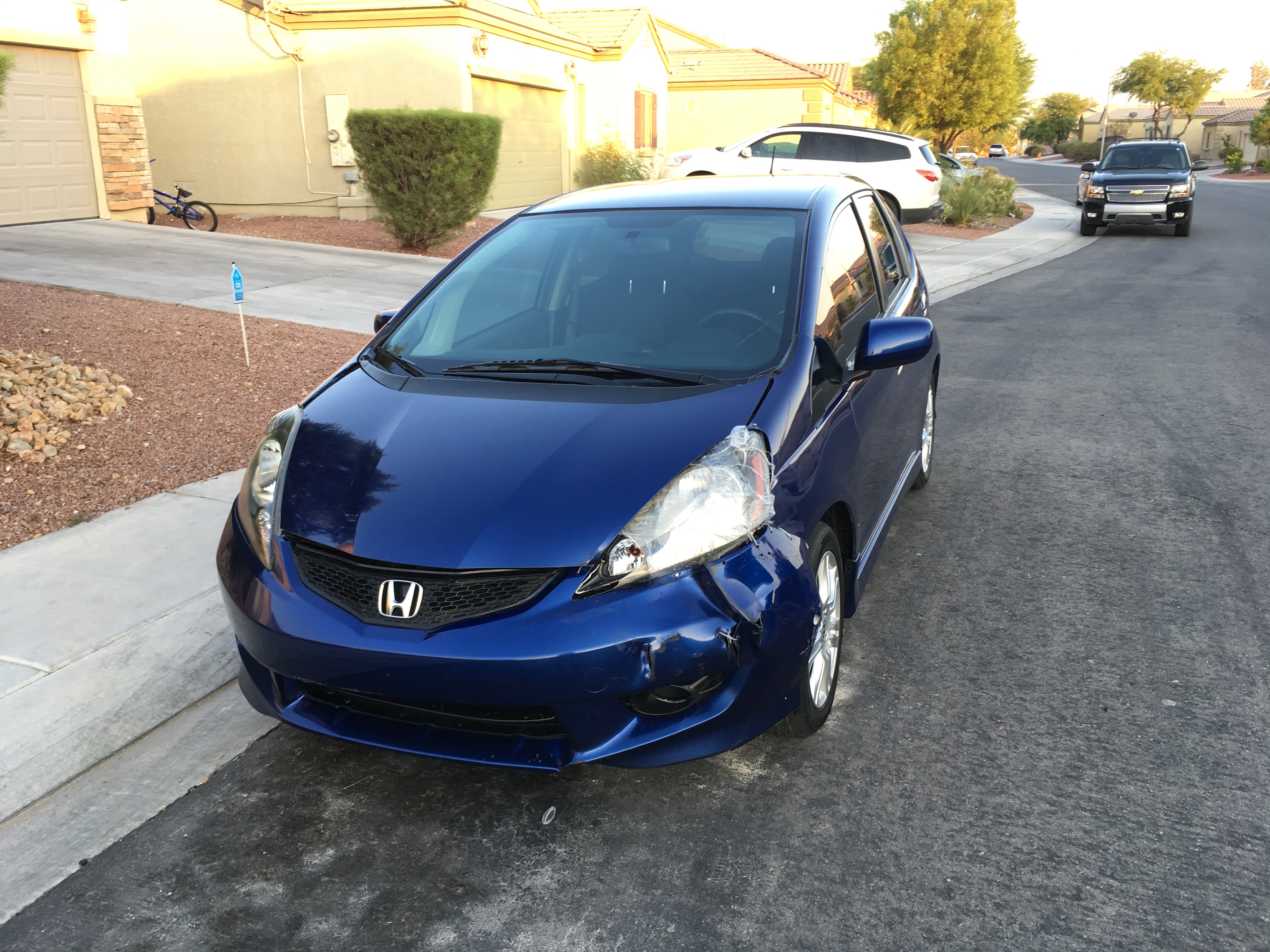

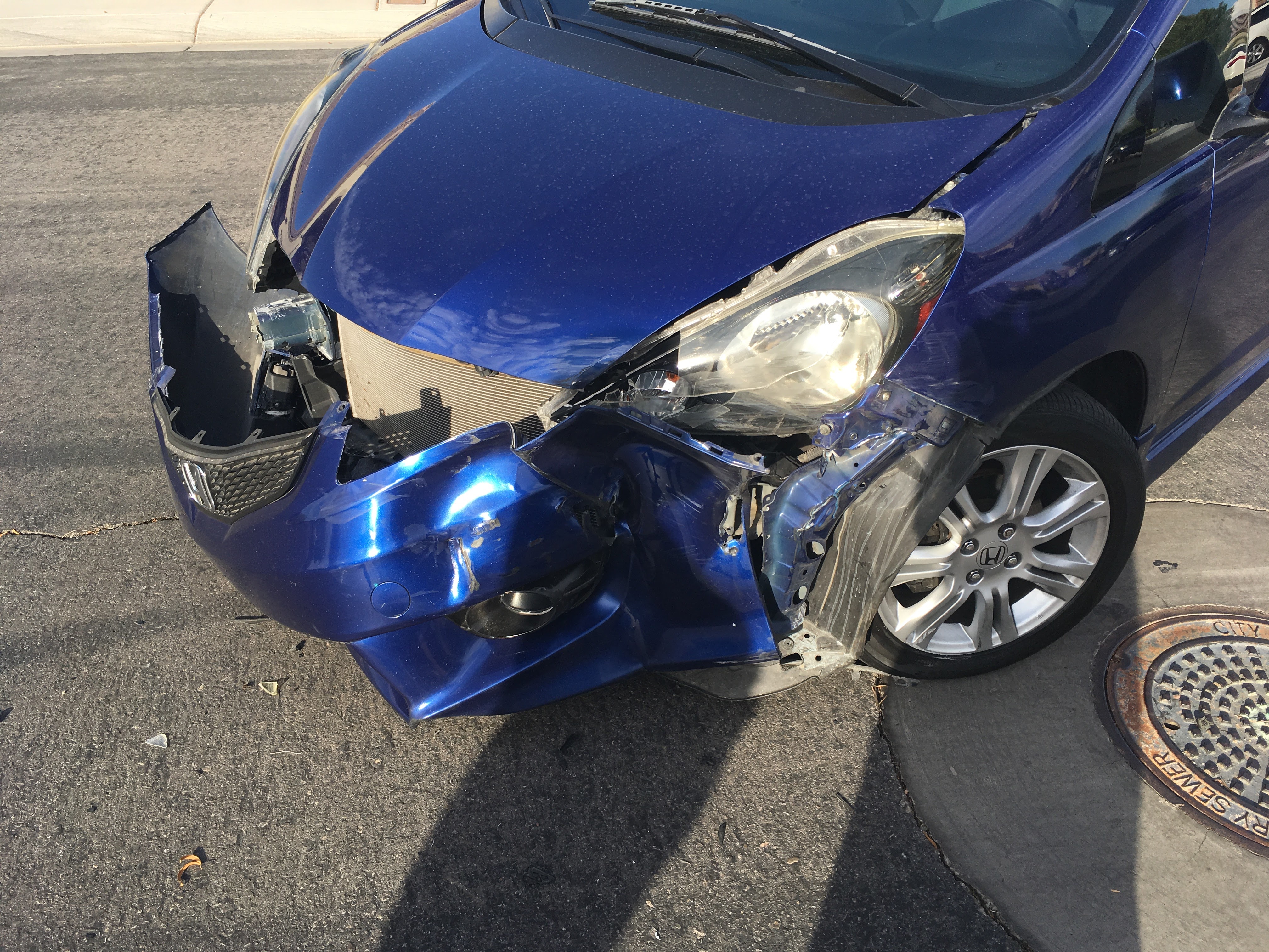

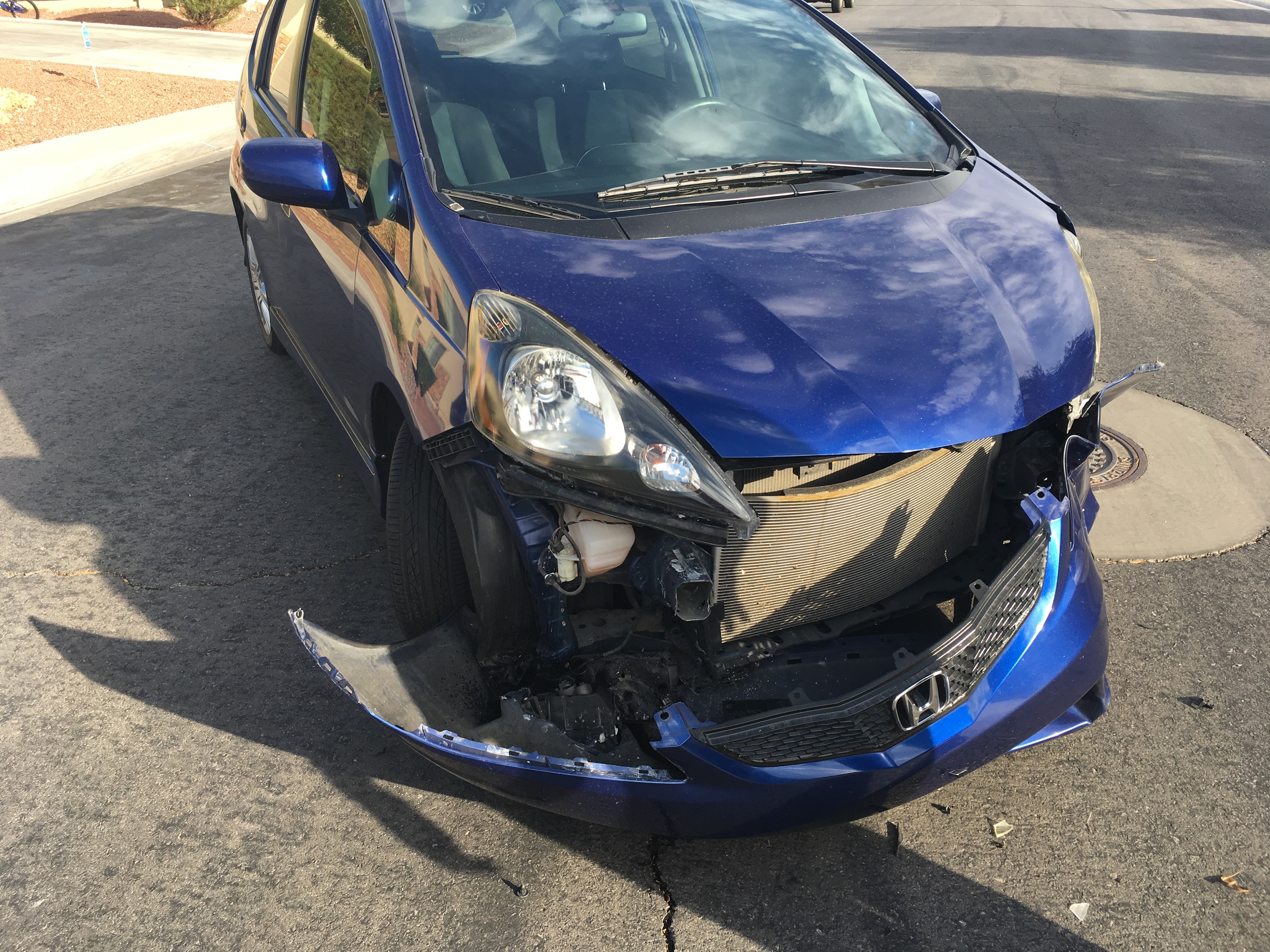

Wrecked my fit :(
I was leaving from being parked in front of my house on the street and i pulled out in front of this lady in a big truck. I feel so bad for the other driver. luckily no one was hurt since it was a low speed residential accident.It was my fault and i only have liability for her car. At this point it is unclear if my fit is totaled or i might be able to fix her. My poor baby RIP.
Ya that happend. I will tear into it this weekend to see is its something i can fix out of my garage. What is a certain sign i will not be able to fix her myself for under 2k? is there a similar thread with a front end tear down? thanks

It sure looks bad but is it only front bumber, hood and left wing+light?

Body Damage Repair
It looks as though you might have to have a little professional help in straightening out the radiator support, as the A/C condensor/radiator is bowed out. Other than that, everything else looks like a remove & replace. Good Luck, and keep us updated on the outcome!

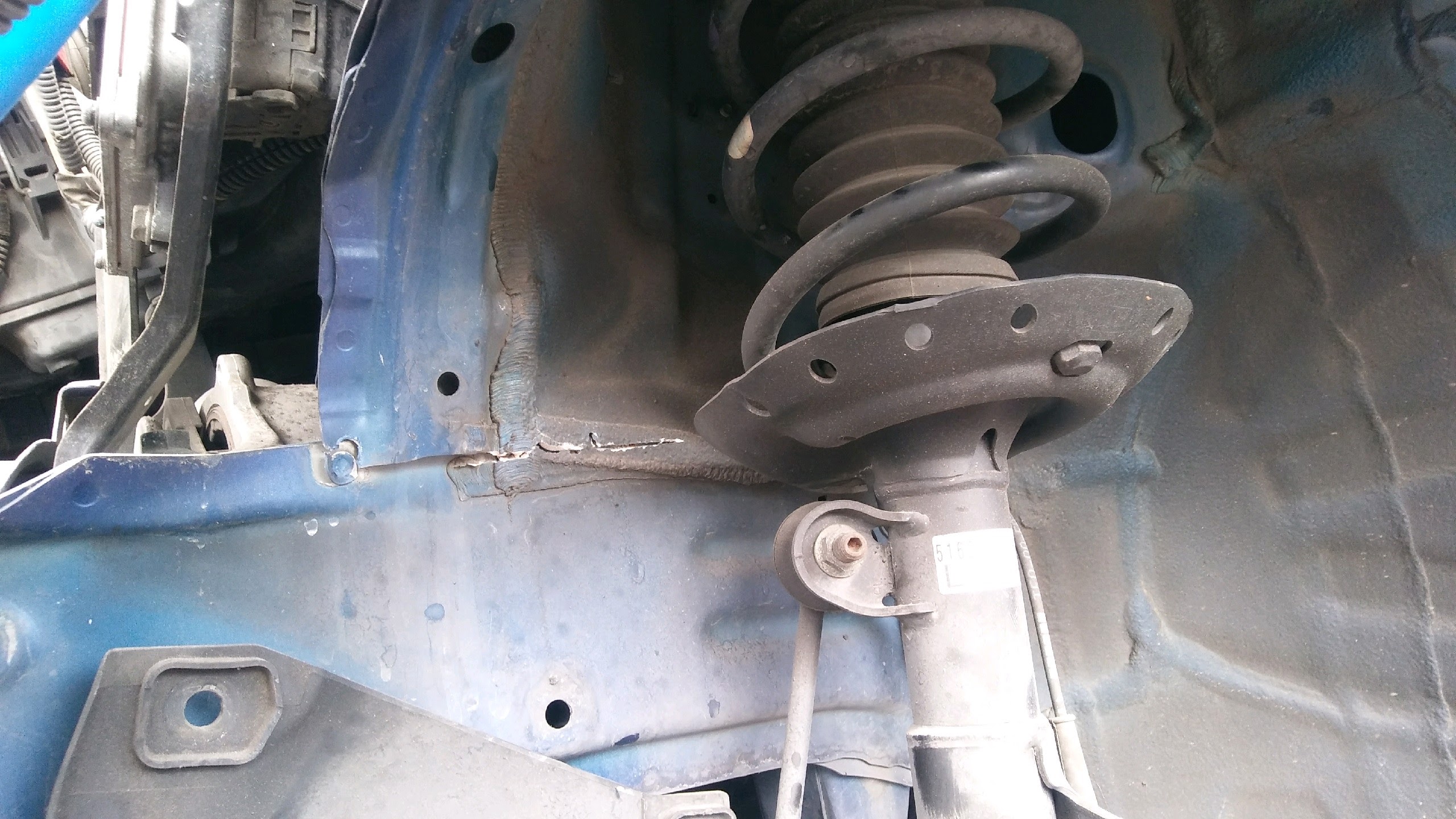

Im flattered you think its newish because its actually an 09 with 185k mi.
Turns out the frame is bent up pretty bad and where it welds to the front shock tower is cracked.
I would like to drive though college as is but the alignment is totally knickerd. and i can only imagine what would happen if i got into a frontal crash with no crash beam and a bent frame...
Still though the fit is a champ for such a light car and even after an accident it only leaks windshield wiper fluid. With my bmws with half as many miles it was a new leak every month....
Its a loss. I bought it for 4k and fixed it up a little. Tires, Valve adjustment, spray painted plastics, oil, shifter, led interior with blue foot well and door lights.All in all about $4500. if i sold it i would be lucky to get $900.

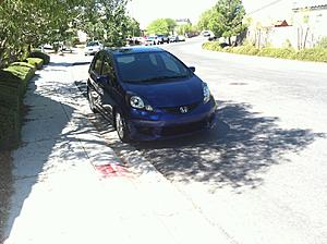

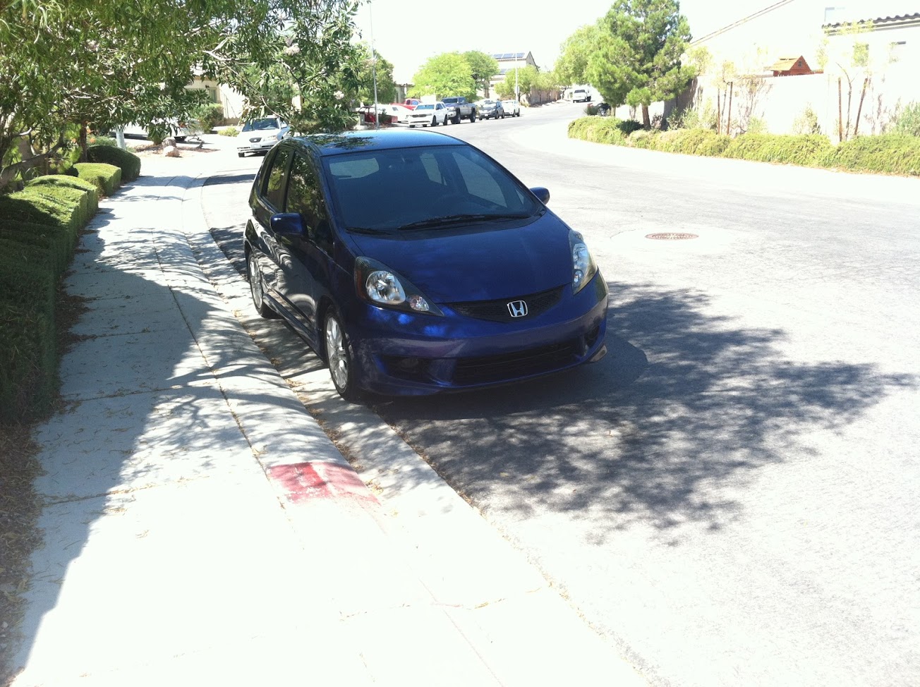

The day before the crash, Lookin like a top
