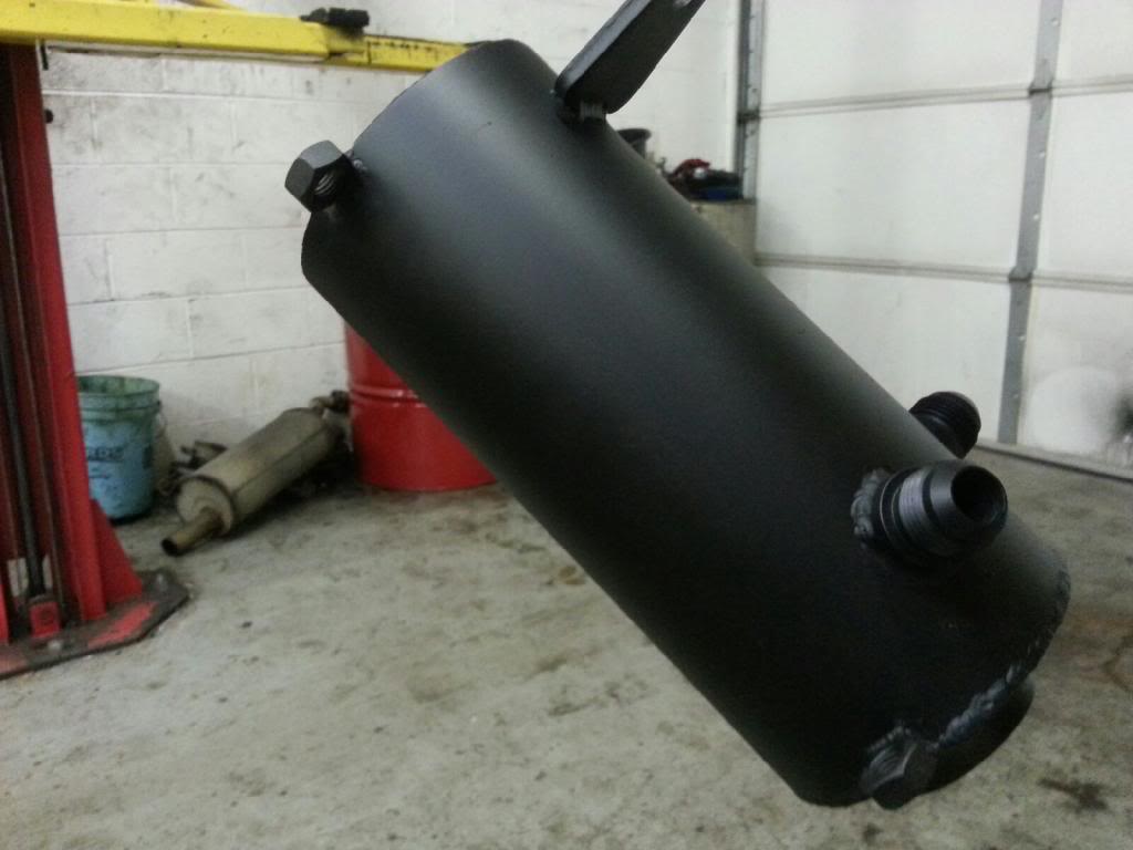

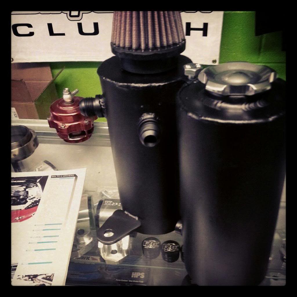

Getting closer:
Coolant -
Oil -

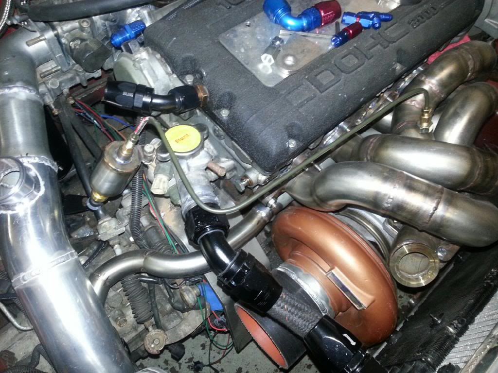

MOAR Fittings!!
For whatever reason the filtered turbo feed port on the filter housing is BSPT thread, not exactly easy to find. I'm wondering if a 3/8NPT would work if I don't crank it down.. or I'm just going to weld a plug, drill and tap it to AN

Cans are done!

Any guesses what this might be?
Old Feb 18, 2013 | 07:19 PM
  #371
TPColgett's Avatar
Posts: 1,952
From: Hayward CA
Meth/water injection system/nozzle? Looks like a probe or pump running into the hot side of the turbo... I know nothing LOL
Old Feb 19, 2013 | 09:44 AM
  #372
DiamondStarMonsters's Avatar
Posts: 4,428
From: Chicago, Illinois
I've actually thought about using steam expansion across the turbine wheel before, but that is actually the completed turbine drive pressure sensor, dampener and an SS hardline.
One of the bits I'm most excited about, and it should answer as many questions as it will create.
Not to mention the bonus of sheer what-the-fuckery for when I pop the hood lol

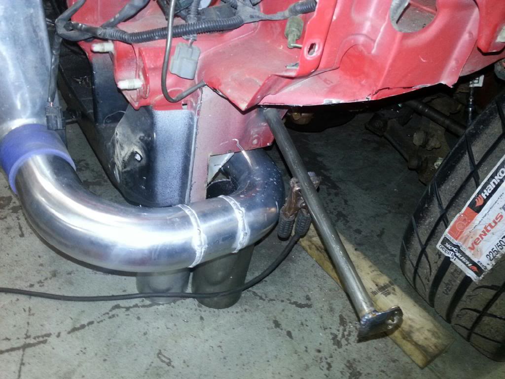

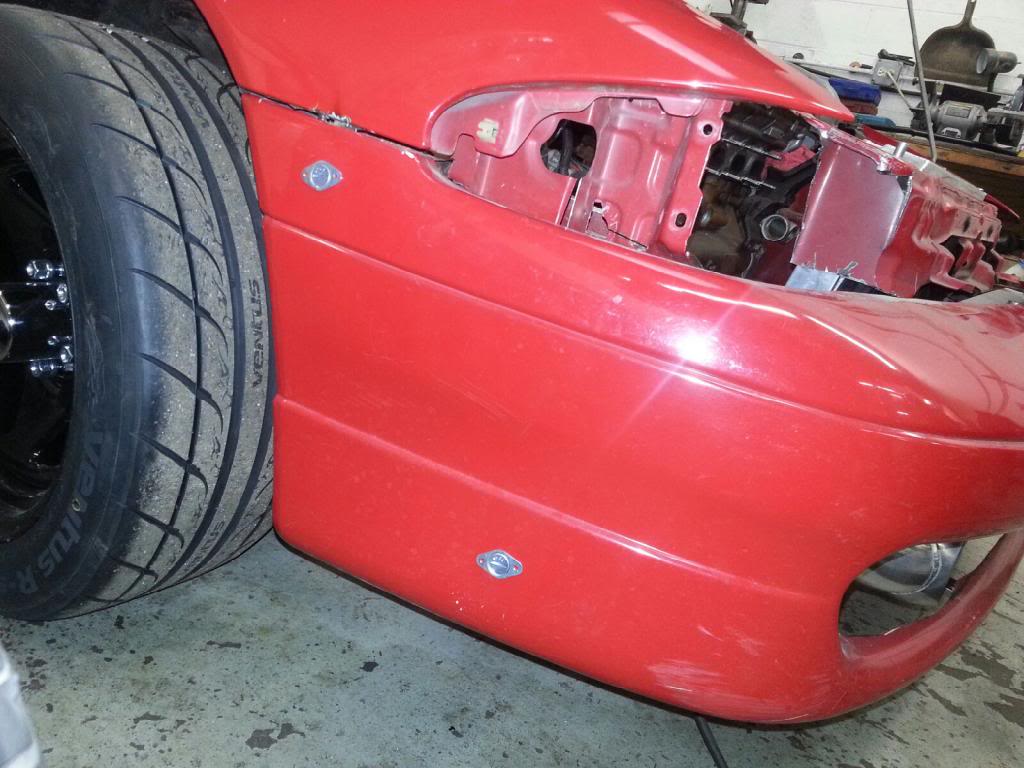

Everything is off at the ceramic coater and the aero work is in progress. Today we're reinforcing the front bumper for the added wind loading with some more Dzus fasteners!
Because masochist!

Stand-off for the other side and bracing in progress:

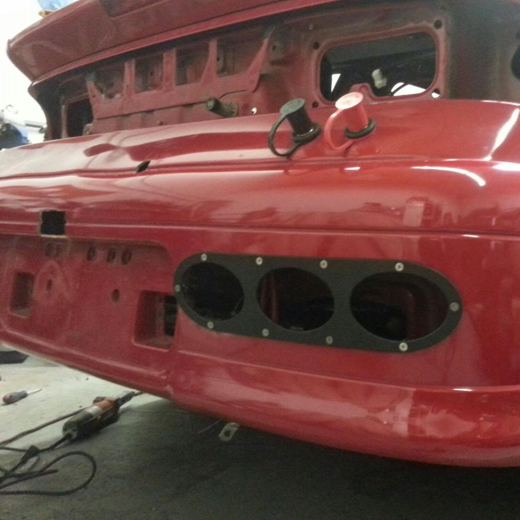

Some speed holes:

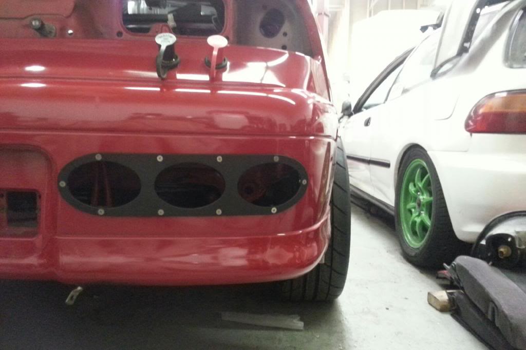

But Dat ASSSS:
Mostly just waiting for a ton of stuff to come back from ceramic and powder coating.. then fluids get filled, systems tested, wire/cable organization and we can fire her up!
