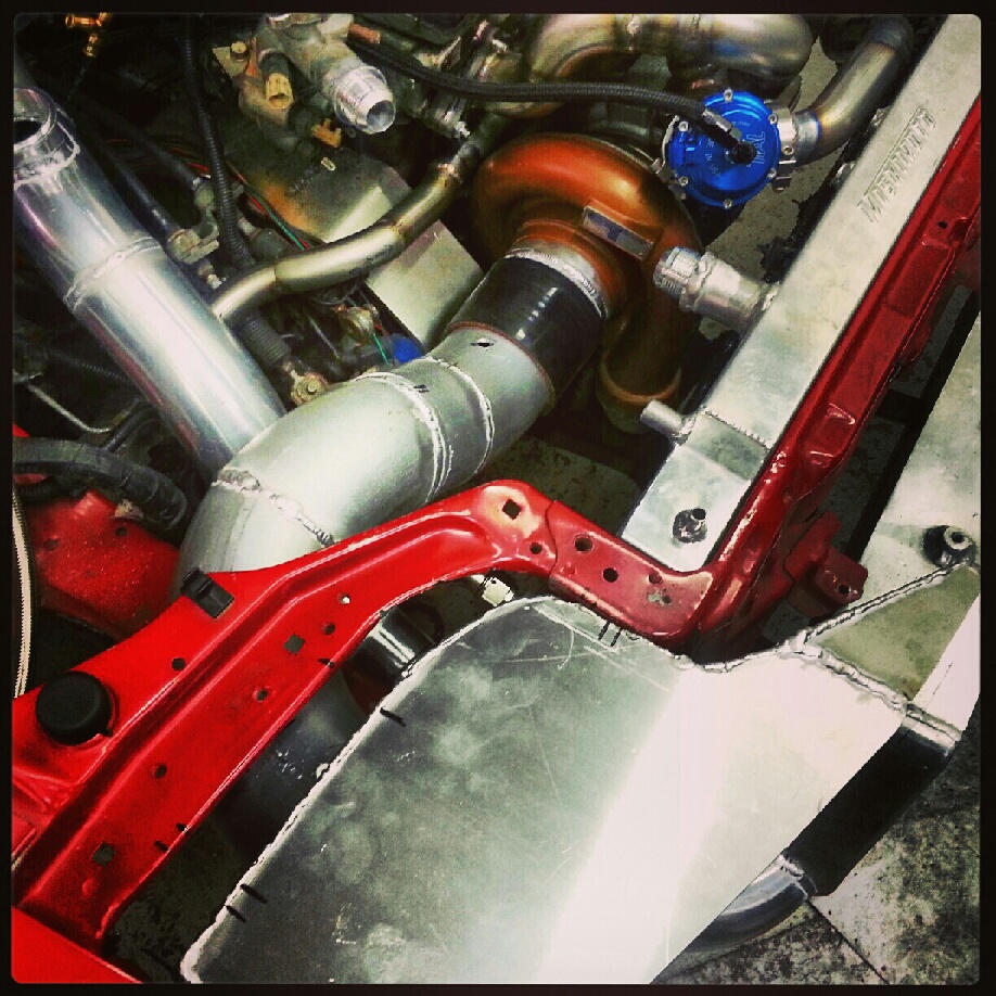

Evolving:

Old Jan 20, 2013 | 11:31 PM
  #322
sr.sedan's Avatar
Posts: 499
From: CALI, IE
Can't wait to see this baby runin

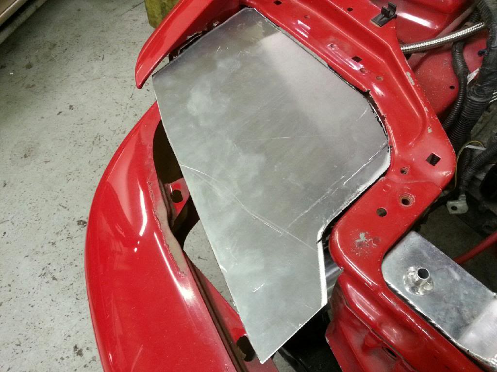

We got some more work done on the head-light intake scoop.. space constraints have required a bit of alteration to the original design but this will still accomplish what we need. Still just the rough copy. Final will be cleaned, sanded and molded leaving no panel gaps and painted hammered black.
Still being mocked up for clean fit

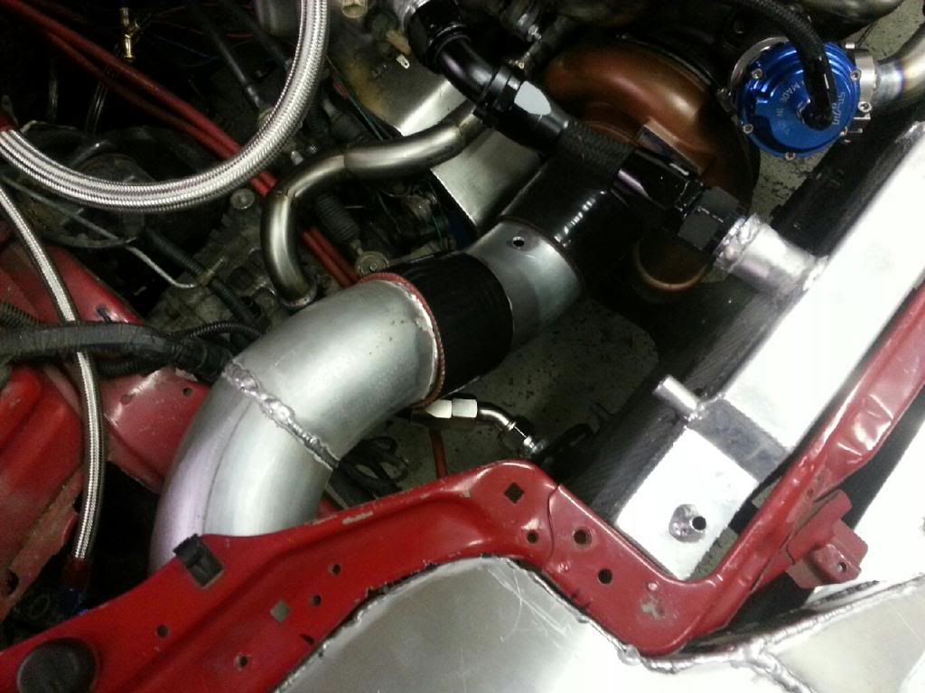

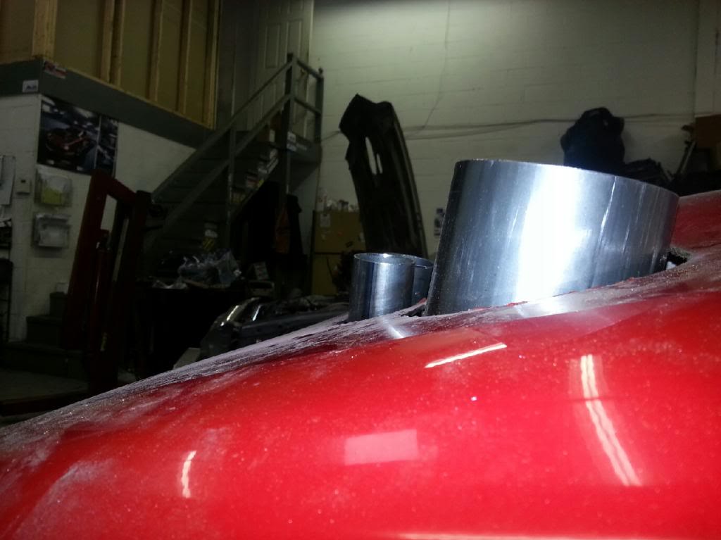

Almost sorted out this intake pipe..
Now just need to finish the rubber sealing, match the end pieces with the fender and then all the piping, intake and exhaust is being sent for ceramic coating! The intake pipe I think will end up coated black, and the downpipe and wastegate dumps will be getting this jet hot type coating. Looks like it glows.

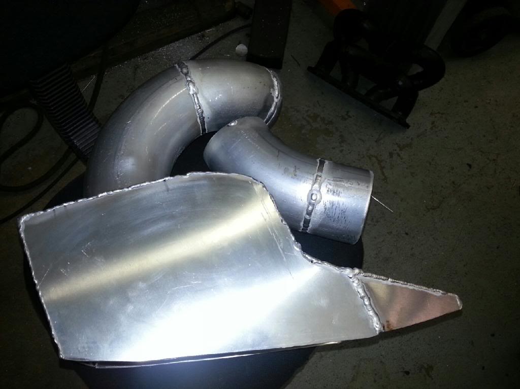

Here's the current iteration of the scoop out of the car and without the weather stripping (probably going to split some vacuum hose to make a snug tight seal)
Old Jan 25, 2013 | 04:14 PM

It's not the prettiest thing ever, and there are more than a few compromises from a flow standpoint.. but we are running out of space and I don't feel like investing almost 1k into an intake pipe lol

Lower Rad hose finally complete!
-16AN lines make the baby jesus cry.. not fun to work with. Hoping I don't have to take that off for a very long time

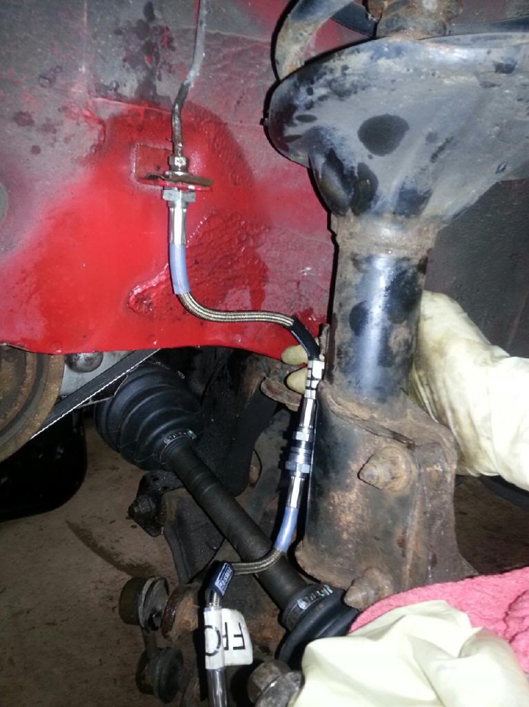

Speaking of hydraulic lines..
Had to replace and re-bend on as it pinched/caved when trying to replace the flexible portion that runs to the caliper.
And for a street/strip car I don't mind the regular rubber/silicon hoses, but as many as I have had bust or develop a pin hole leak I'd rather not chance it on this project.

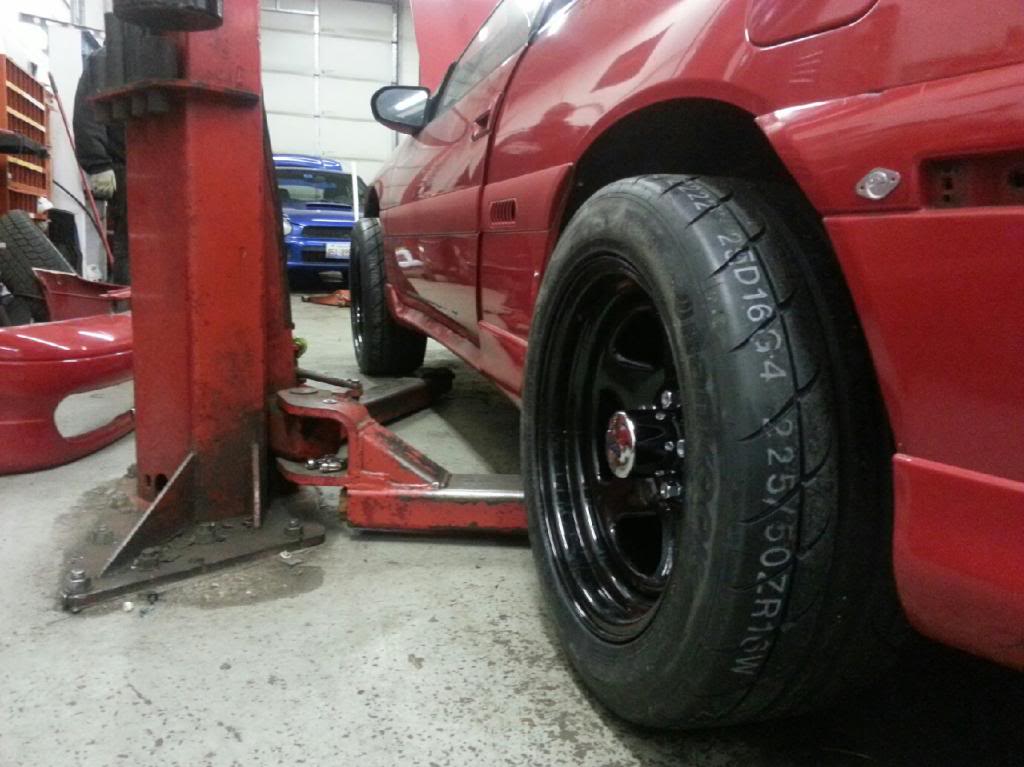

Some final fitting now that the rest of my rad hoses were completed

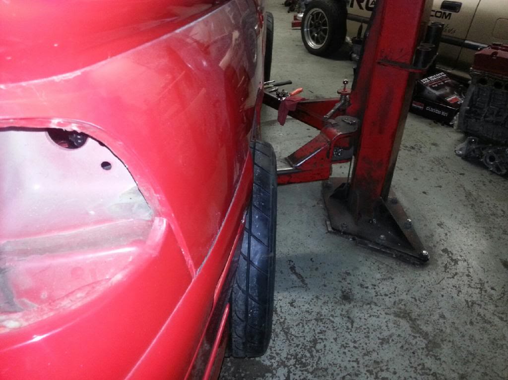

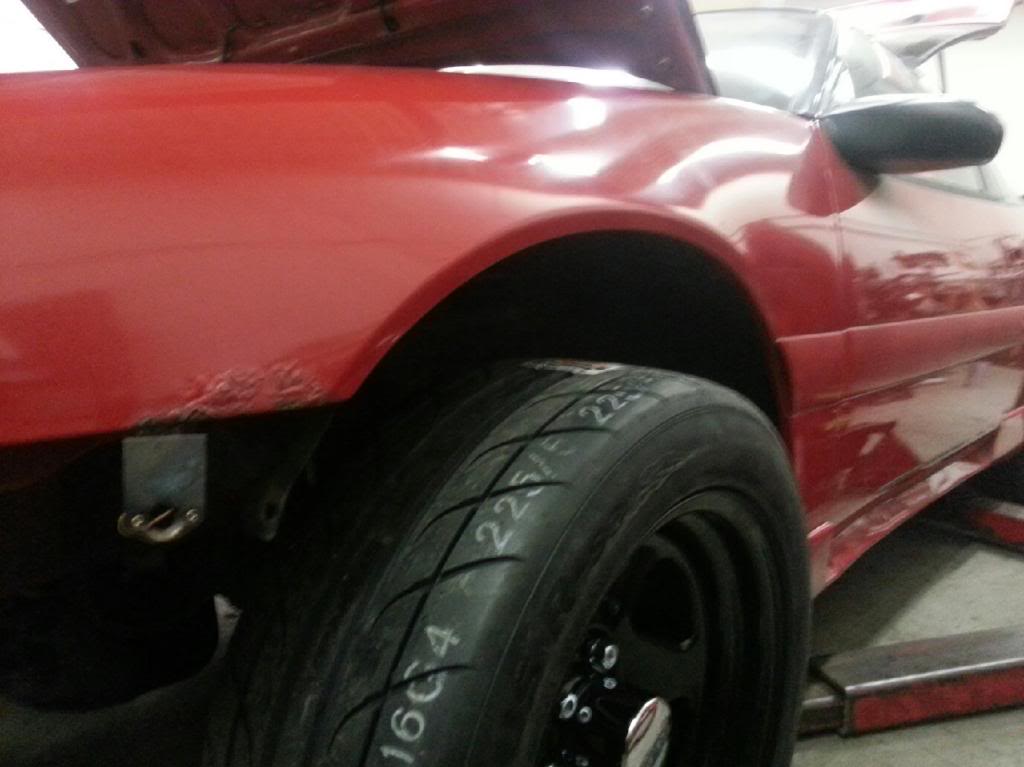

Now even as a strictly "function over form" guy and I knew these were going to poke some when I ordered them as a necessary evil to clear the bigger brakes, knuckle/shock perch, etc.. gotta say this makes me cringe some (warning mike410b may be hospitalized upon viewing this):
Does remind me of Scott McIntyre's Auto-X car, but he has the excuse of running 275s in a car that needs tremendous lateral grip.
Now I have these tires on an 8" wheel to maximize section width. 16" diameter and 4.5 backspacing. These things just barely clear the brakes and give me about a finger and a half between tread and the spring perch.
I realize thats like the distance to the moon for some fitment folks, but this tire will be growing as the car moves along at very high speed.. how much I can only estimate for now.
Now of the Wheel Whores and Fitment Fanatics, who I am sure would love to take me down a peg.. what say you about resolving this if I decide to sell this set all together?
Mind you, a 235/60 drag slick on 15x8s is going to look like that, and I intend to get a set. But these are for the longer runs and street duty. I'm really not digging the mexi-poke/clown shoe look.
Would a 15x8 +38-40 bring that the inch or so farther back into the wheel well I would prefer leaving minimal poke?
Mind you this is in a 5x4.5 bolt and likely a drag wheel from summit/weld/cragar or similar.. Now with what size mid-100s tread wear tire to wrap and get the most section on the pavement while still clearing the the perch/knuckles even with a smaller margin?
I have some thoughts, but clearly got it wrong the first time.
It's why you'll never see me giving advice in a stance/fitment thread outside of being an instigator lol With all the other items in need of my attention I really did not spend much time on this. My usual fitting of drag slicks is the default that popped into my head.. and honestly never thought twice about it.
Ooops. haha
