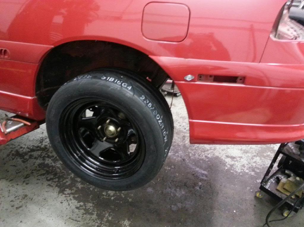

Quick test fitting:

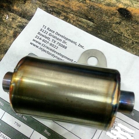

Pulse dampener for the turbine drive pressure sensor came in from Tony @ T1R

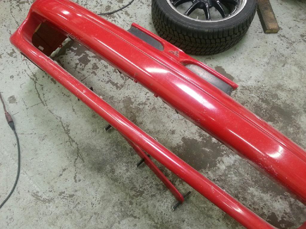

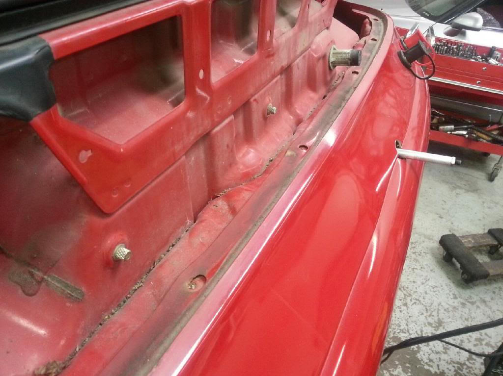

So some of the more dramatic exterior stuff should be getting sorted out this week.. trying to find a way to keep pressure under the back of the car low and keep the cover from getting ripped off by a few hundred pounds of aero drag at speed
So in addition to a couple multi-port diffusers put into the cover we are latching it with metal studs off the chassis at the top and the bottom:

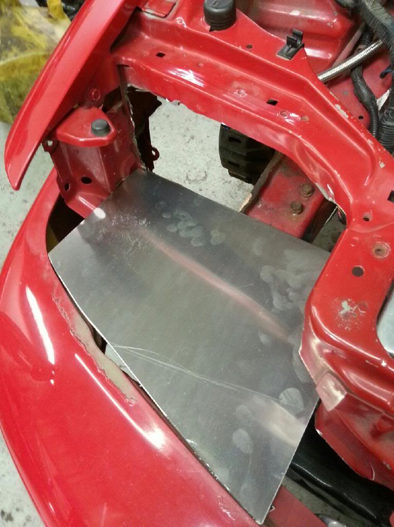

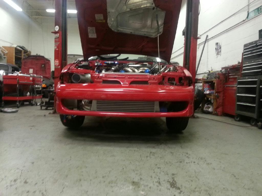

And on the front we are trying to massage the cover to fit the big ass intercooler:

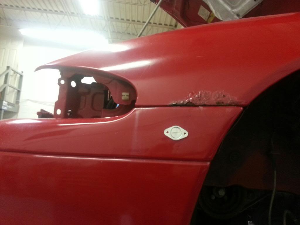

Yes I have to Fix that rust spot. The whole car is getting touched up after its running and I am having the underbody sprayed with rhino-liner.

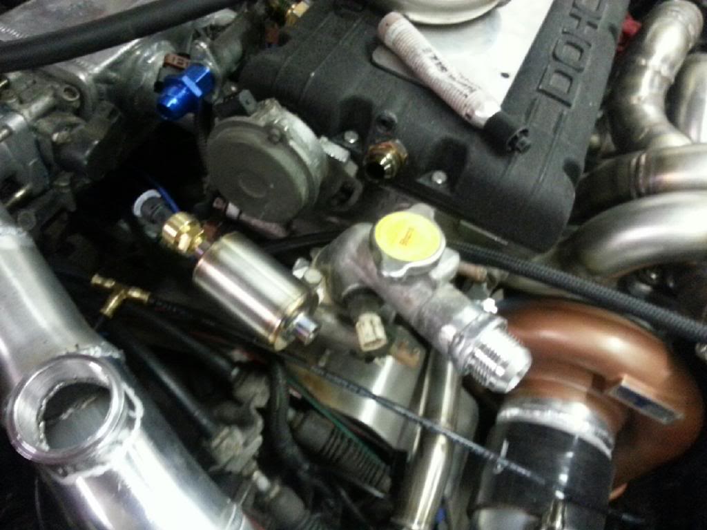

Third meth nozzle is now in the pre-turbo pipe

Mounting the drive pressure sensor and damper, then fitting a stainless line coil

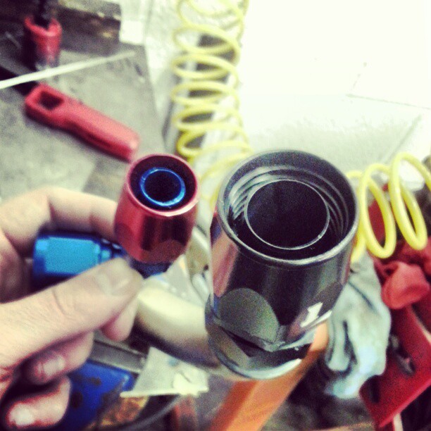

These fittings are so big they make the gap between the radiator and t-stat housing look tiny.. like we zoomed way in on some -6 hose ends

-10 for fuel (which by all standards is a big fucking fuel line) next to a -16 for radiator hose:
And they go all the way up to -32 (2")

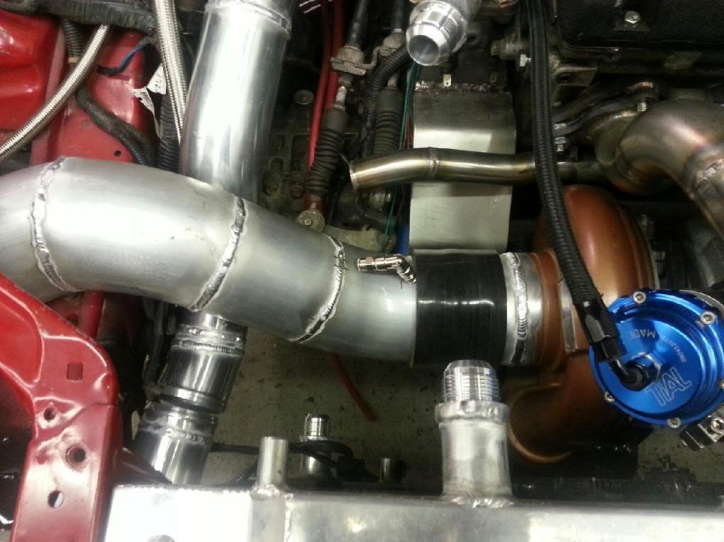

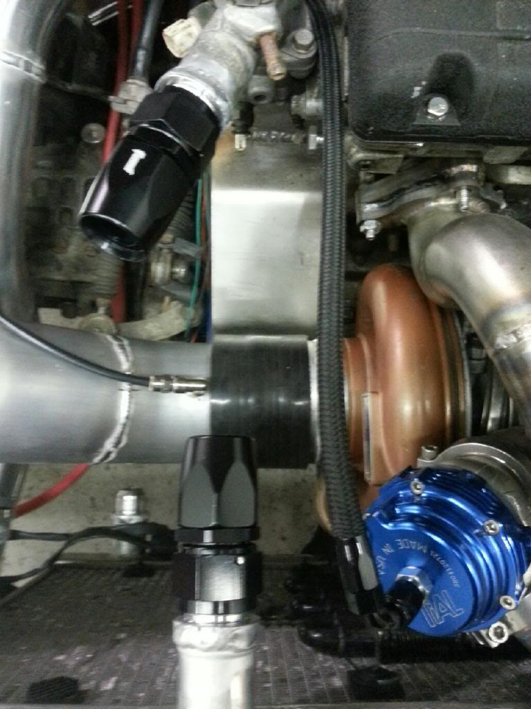

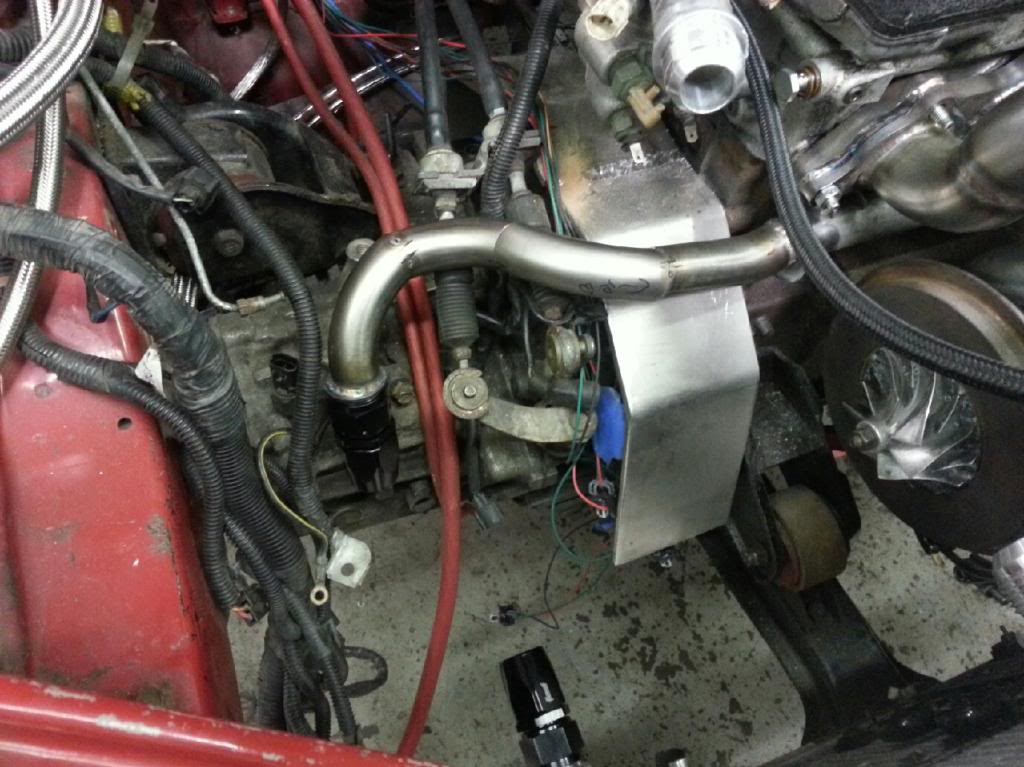

This lower radiator hose situation with everything else that's in the way is proving to be tricky.. heres what we got now:

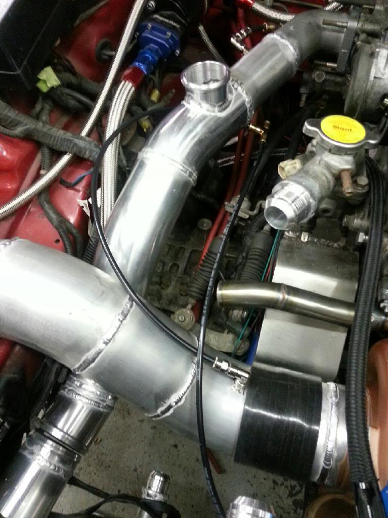

Hell bent on getting this headlight replacing pre-turbo ram air scoop sorted out.
Even more interested to see how this plays with turbine efficiency with and without the scoop on.. measuring that by comparing boost to turbine drive pressure and pre vs post turbine exhaust gas temps and airflow/power production!
On a turbo this size and at the speeds I am aiming for it should make for a noticeable bump in power.
