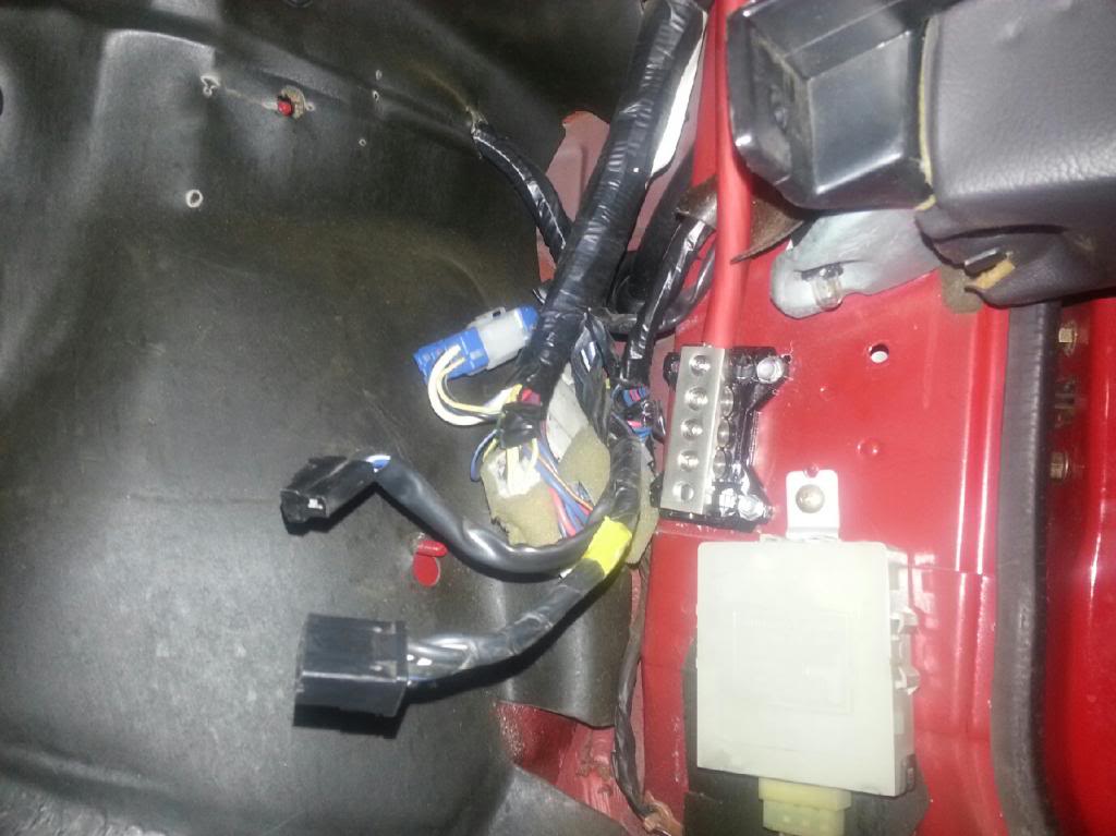

Routing the wires to where the glove box used to be for the fuse/breaker/distribution panel:

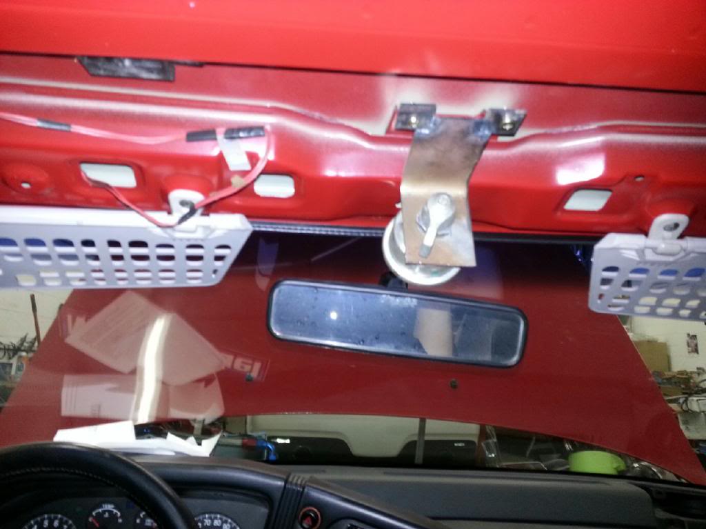

Beginning fab on the in-cabin shut off switch and parachute release handle on the roof:

Slowly but surely:

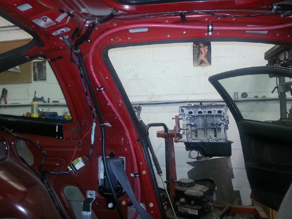

Lookin like I will be able to hide alot of this too as there are some convenient channels in the sheet metal unoccupied by OE wiring under the interior panels

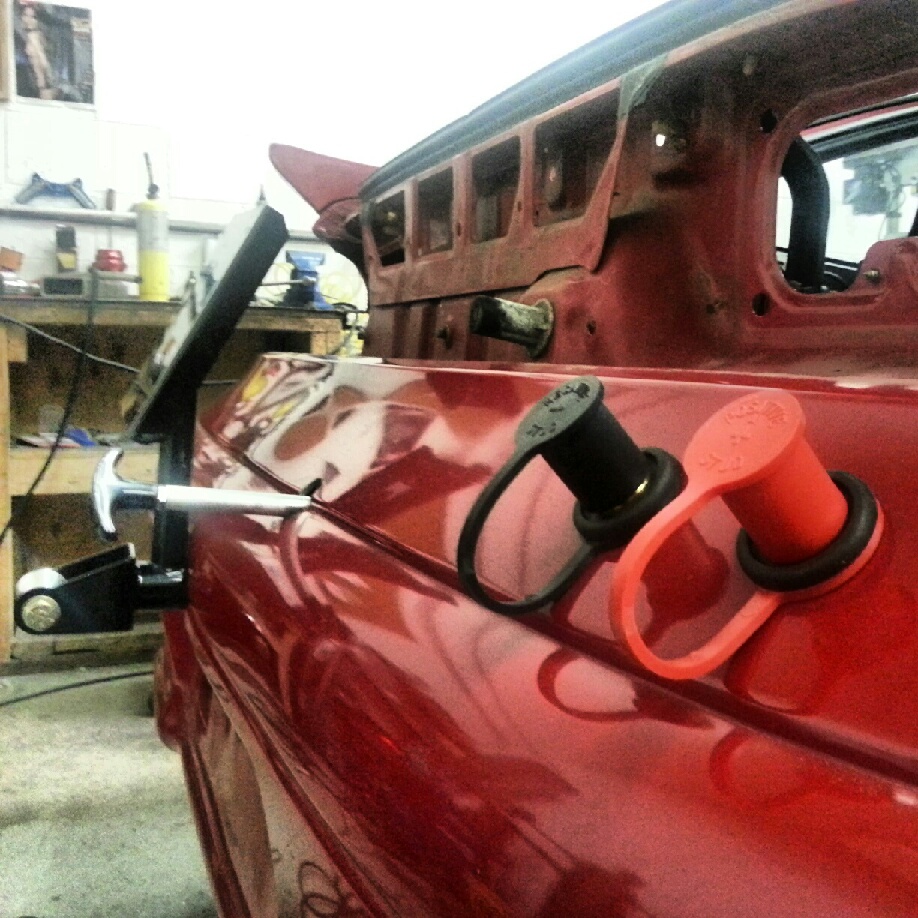

External charge posts - Done!

I think the external 12vDC posts and ample cargo space will make for a hell of a tailgate machine! Chute could pull double duty as a tent!

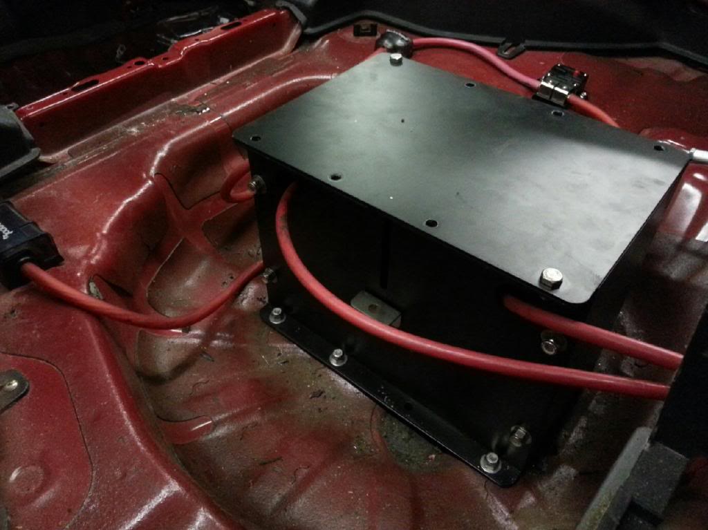

Who knew making a concealable locking/hinged breaker panel was such a pain in the ass?

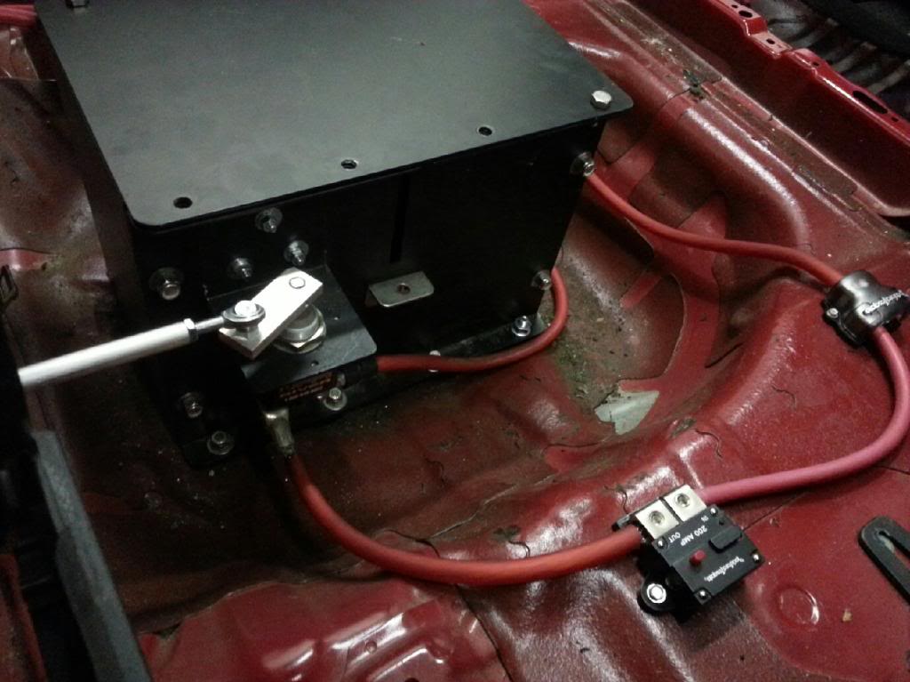

More wires! Fuse all the things!
Ended up using almost entirely Rockford Fosgate hardware
