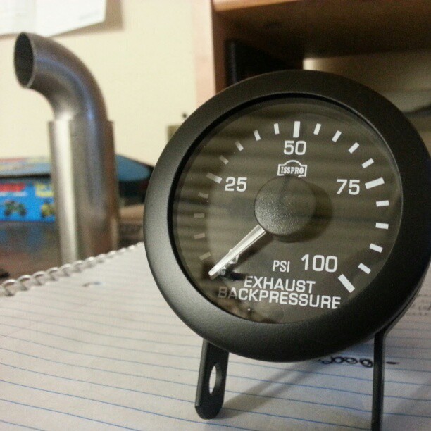

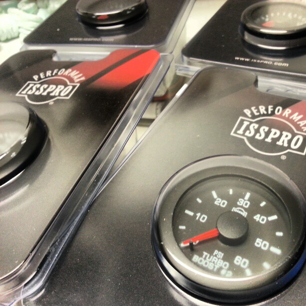

Gauges arrived, these things are sharp and brilliant modular wiring. Would Recommend ISSPro to anyone looking for gauges and I have a contact for them if interested:

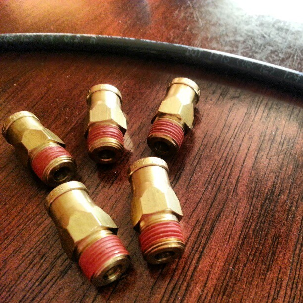

Diving in head first we grabbed a bunch of the DOT Push to Lock hardware, will report back on experience after install and again after running them, seems promising:

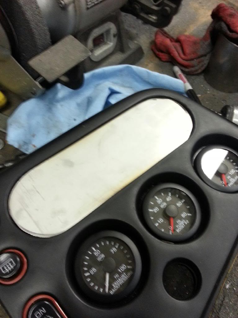

Starting to get the gauges in:

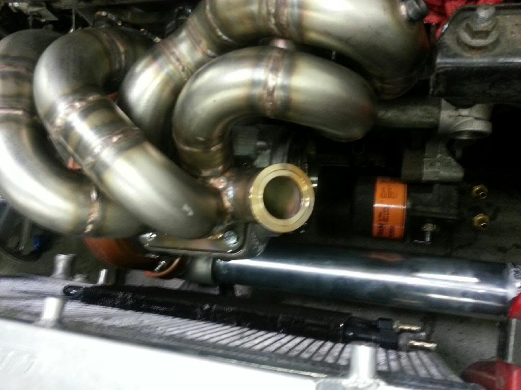

Remote Oil cooler mounted, should allow for two full-size rad fans and a 7" fan on the oil cooler

Making a Vent-Delete to mount the rest:

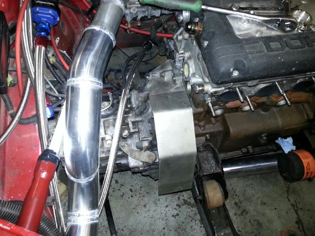

From: Chicago, Illinois
Revisions made to the Trans Shield

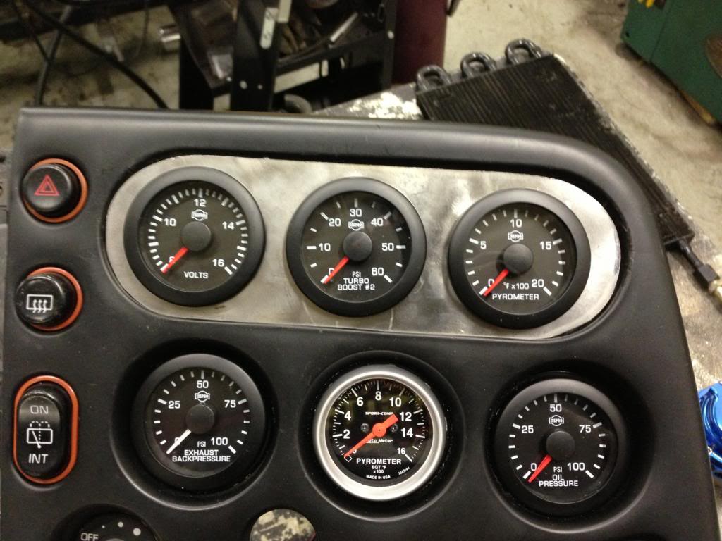

180* Shield finished, provisioned for a full 360* when required by certain sanctioning bodies
Waiting on one more gauge (ignore the silver bezel pyro), not the final order they will be in but basically how the console will look when done and then the wideband will be under the switch panel next to the turbo timer and electronic boost controller

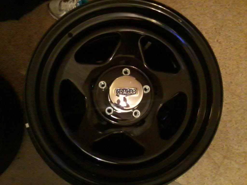

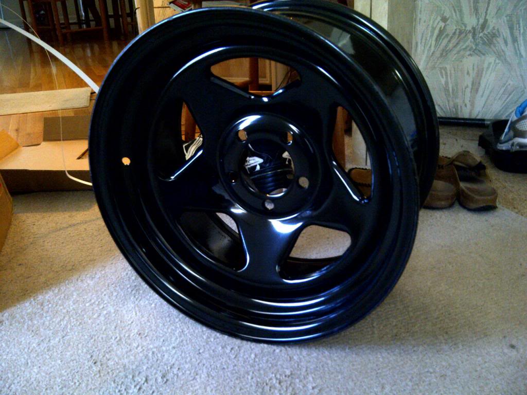

Street wheels arrived today:
16x8 with 4.5 BS Cragars.
Billet Center caps and Hankook Ventus RS3's in 225/50 coming this afternoon!
Going to be running these at the Chicago Half-Mile shootout in June!

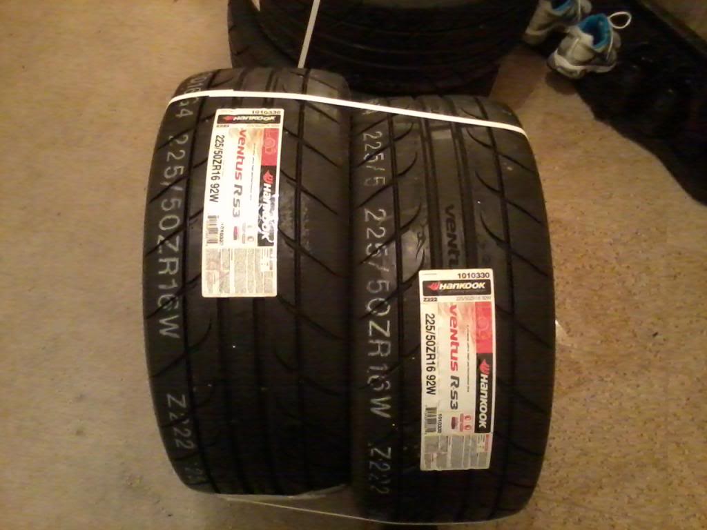

center caps due tomorrow.. but the tires made it:

Caps, lugs and such.

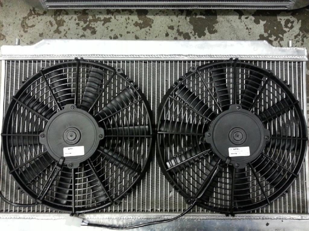

Think this should be enough cooling.. two 14" SPAL fans on the radiator and a 7" on the remote oil cooler

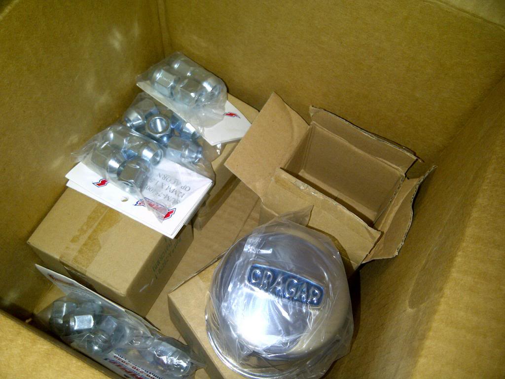

Caps and open ended lugs

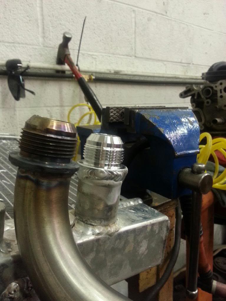

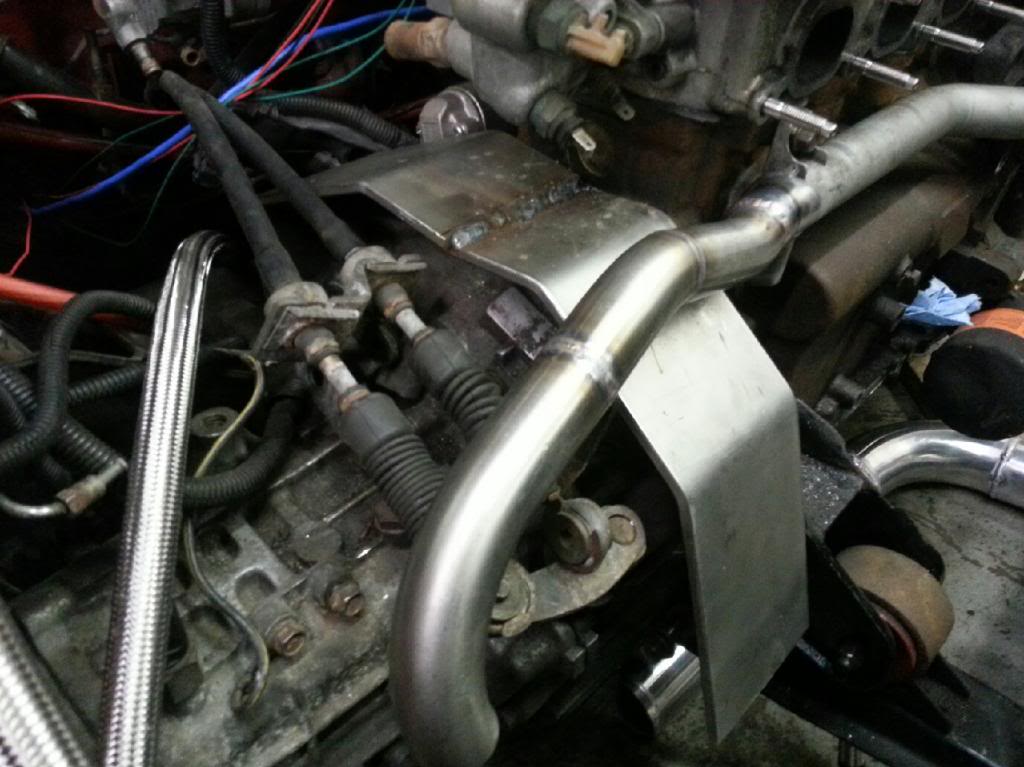

Converting all the fluid fittings in the car to push lock or AN
Thermostat housing, waterpump and radiator all having -16AN fittings welded on.
This is the water pipe being modified to clear the trans shield, shifter cables and the soon to be 5" turbo inlet pipe
