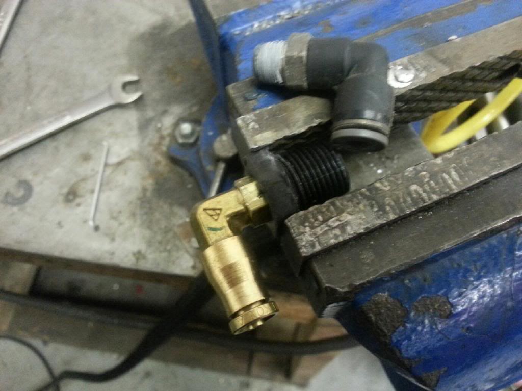

Really digging these DOT-spec push-to-lock fittings. Especially compared to the plastic/nylon junk I'm used to using for meth systems.
Behold!
These are used primarily on high-pressure airlines for semi-truck brakes. I'll be using them for vacuum/boost controlled devices as well as the meth system.

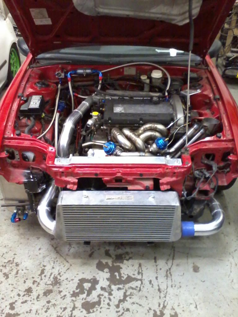

Brief update, lots of stuff I have yet to shoot a picture of..
Last big picture shot I took last week:

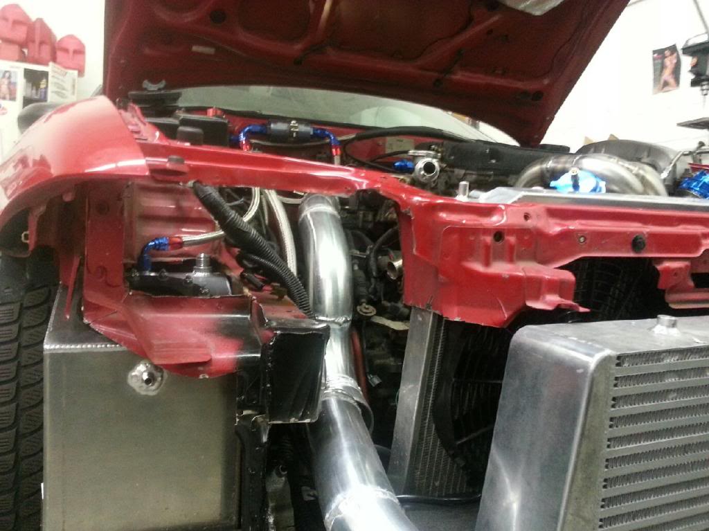

More core support mods to accomodate the big head-light replacing scoop intake pipe:

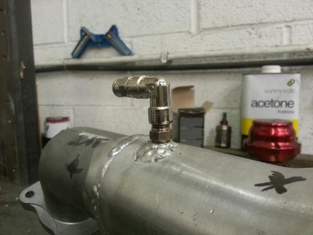

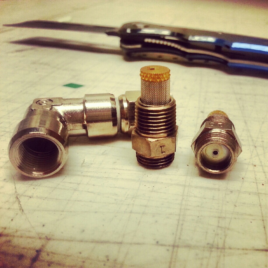

All 3 meth nozzles arrived today.. 2x 2GPH and 1x 10GPH:
Big nozzle installed up by the throttle body:
Other two are going immediately in front of and after the turbo

Total of 14GPH (rated @ 150psi) would give me ~870cc/min. They will be fed by a 250psi pump, and the nozzle manufacturer said that they should move ~1000cc/min all together.
5 mile/2xx mph pass should chug about a gallon.
Depending on primary fuel type.. the car could be as much as 23lbs lighter at the end of the run lol
I may end up using larger jets and a bigger reservoir though.
